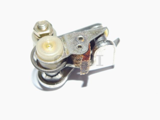

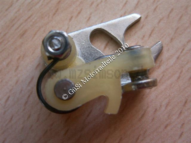

Postby Puffs » Thu Aug 01, 2019 4:07 am
Yes, but now you're confusing me again Guesi, those
are not original either, the originals are:
Those are the pertinax ones, the other ones are nylon.

Puffs wrote:Yes, but now you're confusing me again Guesi, those
Sorry, did not know that you meant the pertinax version when you asked about the price...
The pertinax are special version (long lasting). The nylon ones were the normal ones.
