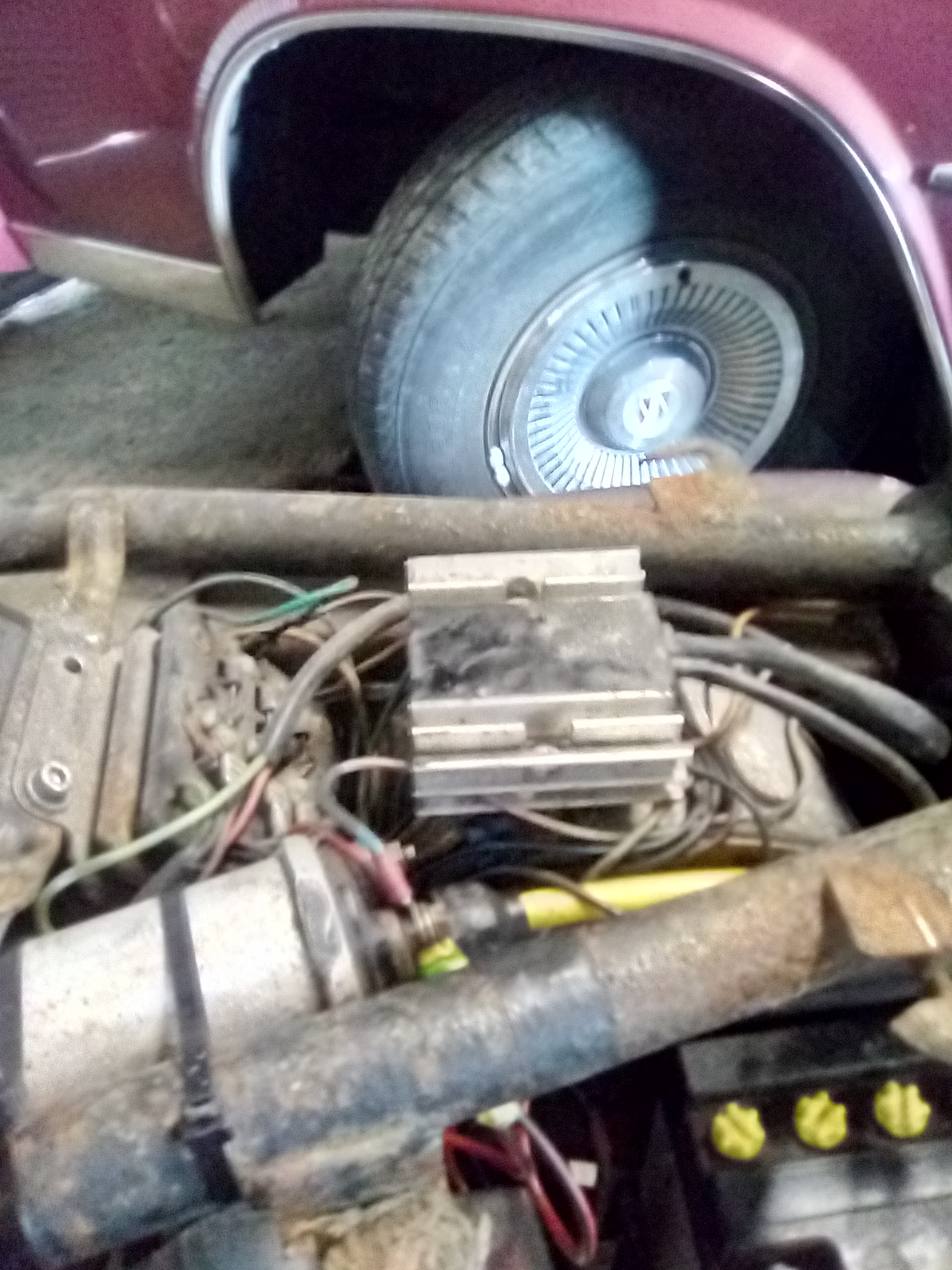

Postby DAVID THOMPSON » Mon Feb 24, 2020 10:15 am
the box in the trunk controls charge to the big battery to about 2 amps
the car can do ok with a 10 watt radio but no one can hear me with that low power
i have not used the trailer and radio at same time
i got it to haul junk when i sold the truck
