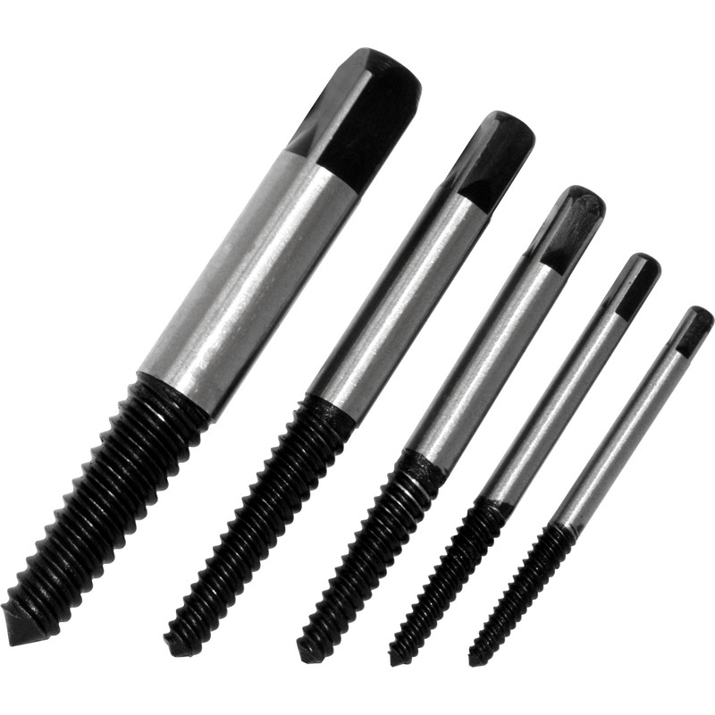

If you can drill a hole in what's left of the bolt, from the LH side (so through the bolt hole in the case), and then try to screw in one of those bolt extractors:
and then, once you feel some resistance, lift the engine (with a jack or so), to take off the friction in the case hole, you might get that end out & the sun will shine again.
You probably need to make an extension for that extractor.

Yes I remember the welded nut, which is inaccessible. Still the problem is one of only drilling and collapsing the screw with the engine supported.
I am content that everything is tight (enough) to not make it an immediate problem - it just so happens my 3rd gear started skipping, but seem to overcome any issues riding the clutch!
Screw extractor could work, but as someone that snapped one when using the wrong size.... Probably best to drill, or pivot the engine when that time comes.
