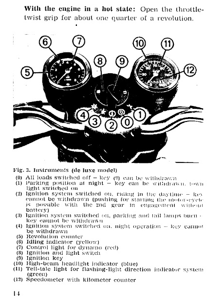

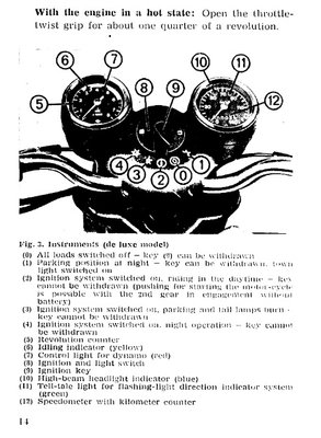

Postby Blurredman » Fri May 29, 2020 2:01 am
Hi.
I have found in the owner's handbook:
You can find it in page 14 here:
ftp://blurredmanswebsite.ddns.net/Vehic ... ndbook.pdf
You use position 3 for tail and pilot lamp to be illuminated.
Position 4 for dipped beam. Position 0 is pilot lamps on, but ignition off.. For parking in an unlit road.
Posts: 1262
Re: Key position and lights
Postby Lpo90 » Fri May 29, 2020 4:47 am
Cheers, seems my front pilot/sidelight isn’t working then. My previous etz was the same. Thank you.
