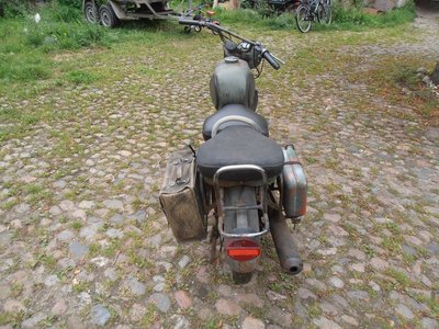

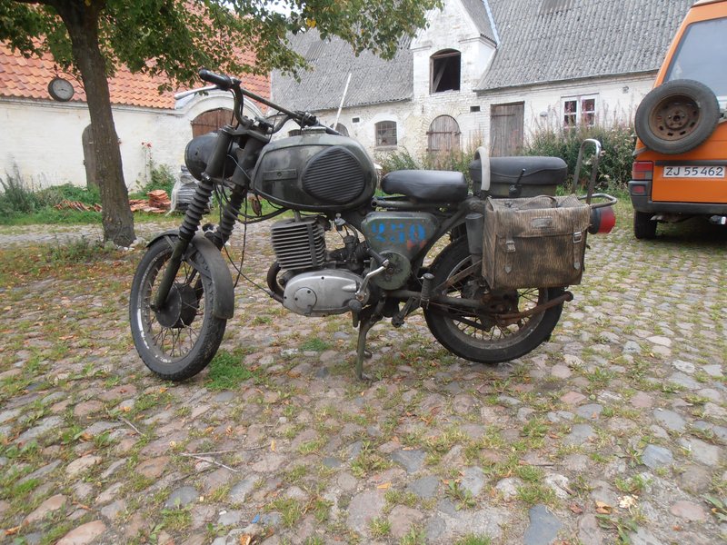

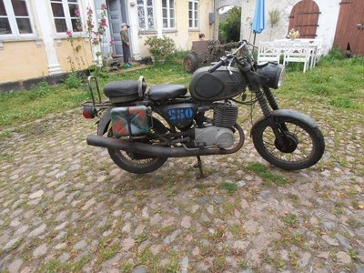

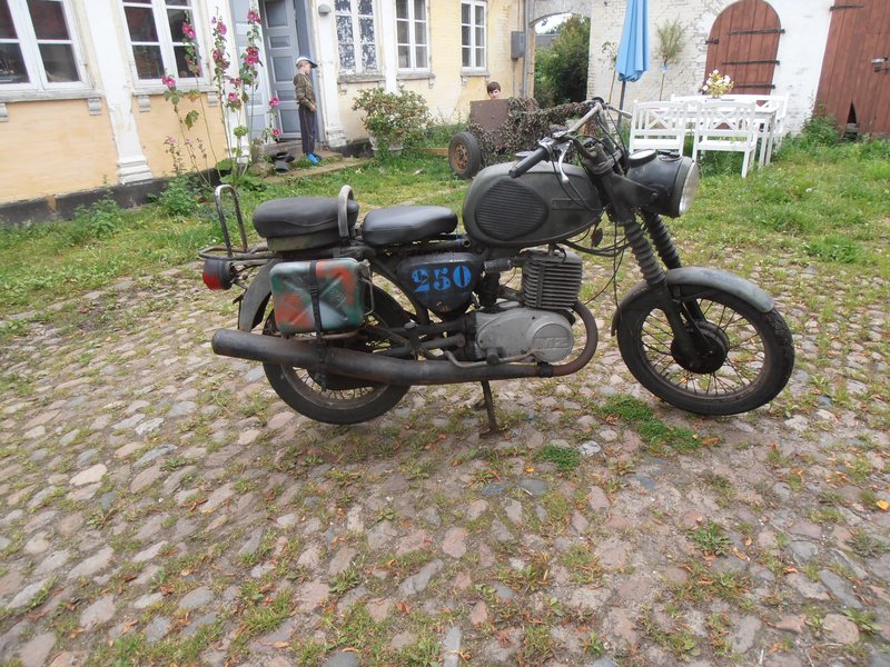

I also checked the VIN-number in order to see if I could learn more about the bikes history. The number is in the 879xxxx area, which apparantly is a ts250 'erzatzrahme' or spare frame. But since it is first registered in 1981 - 5 years after that model was discontinued. and also based on the engineblock, I suspect that a ts250/1A NVA-bike with a broken frame, was rebuilt by the military, onto my spare frame. It is just a guess, but maybe someone knows of distinguishing features on the frame, that only the NVA used? Can anyone see from the pictures whether I have the 5-speed gearbox, confirming that it is a /1 engine?
Apart from the NVA, the TS250A was apparantly also used by the MdI (Ministry of Interior) for police work. I am a bit confused about excactly how the different versions of the TS250A and TS250/1A were equipped and painted. Any good ressources I could study up on?
As the pictures show, there are a few parts missing, and the strichtarn-sidebag, isnt the correct bag. But there are a lot of parts which seem specific to the military models, so I am quite confident that the bike has done service with the NVA. Can anyone enlighten me further, as to how I can learn more about this?
