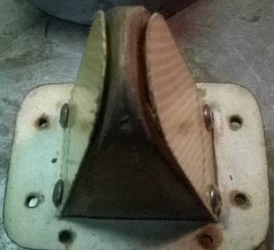

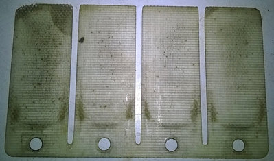

I had made those reeds from Aramide (=Kevlar) fibre impregnated with epoxy, and I had chosen that fibre because of its resilience. Those kevlar strands are very difficult to break, and consequently, the reeds are quite stable. They shouldn't break, and therefore pose very little risk to the engine.
Nevertheless, with time a crack appeared in both of them, at the location where they bend strongest:
Dark line in reeds indicates crack (kevlar - ragged edges)
02 - Dark line in reeds indicates crack (kevlar - ragged edges).jpg (27.3 KiB) Viewed 306 times
Note that the ragged edges are not necessarily a sign of wear, this material is quite difficult to work & shape. Tools (files/grinders/knives/drills) remove the binding epoxy fine, but fail to properly cut the aramide strands. A good example are the holes I drilled to fit the reeds; obviously there is no wear there (no movement), but you just cannot drill a decent hole in this stuff with normal tools.
But that's not the issue, the problem is that both reeds are more or less cracked, about 6mm upwards from the holes. A darkened line indicates that crack: some fluid has impregnated there. Maybe oil, although in those days I used the oil pump, yet some mixture will blow back. Those cracks have caused the reeds to bend:
Aramid reeds are bent @ crack
03 - Kevlar reeds are bent @ crack.jpg (11.85 KiB) Viewed 306 times
And that causes the whole reed valve to stay open in its neutral state:

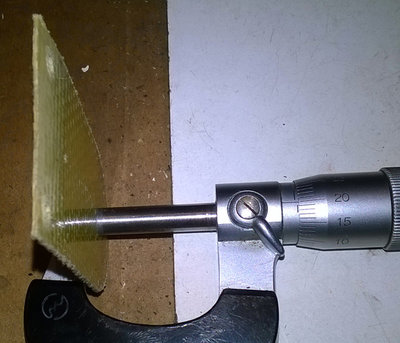

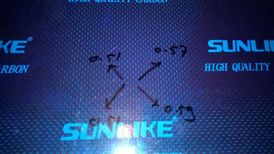

Hence I bought a sheet of 0.50mm Carbon Fibre (CF) from China. I measured it on all the corners, and the the thickness varies a bit:
CF plate (245 x 300mm), thickness varies 0.51 - 0.59mm
07 - CF plate (245 x 300mm), thickness varies 0.51 - 0.59mm.jpg (37.35 KiB) Viewed 306 times
But within acceptable limits (stated by the seller), and good enough for my intended use (I also had another non-bike related purpose for it).

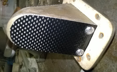

So I selected a location and made 2 new reeds out of it:
CF reeds fitted
07 - CF reeds fitted.jpg (31.97 KiB) Viewed 306 times

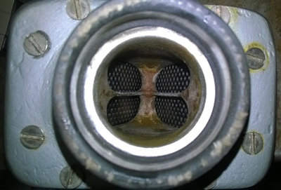

And assembled the valve again, with the 8 screws (which once were of plain steel, hence the corrosion traces on the gasket).

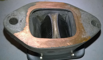

CF reeds installed (seen from carb side)
08 - CF reeds installed (seen from carb side).jpg (32.04 KiB) Viewed 306 times
CF reeds installed (seen from engine side)
09 - CF reeds installed (seen from engine side).jpg (26.41 KiB) Viewed 306 times

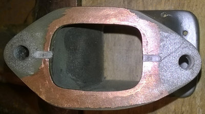

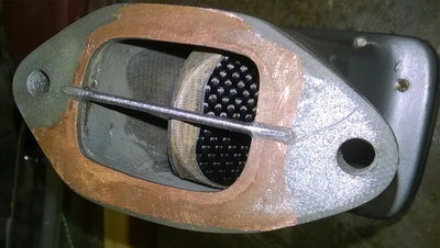

So my main worry was to prevent that if a reed broke, roughly along the line where the original ones cracked, the shard would enter into the engine. I decided to fit a single bar in the length direction. That should be adequate in preventing damage, and while it will cause some extra drag, the performance reduction should be minor. I choose to use a D=2.5mm nail.
10 - Make slit for 2.5mm nail.jpg (27.23 KiB) Viewed 306 times
And fitted it:
11 - Fit nail & adapt reed.jpg (29.13 KiB) Viewed 306 times
Because of the angles, the LH reed would hit the nail when fully opened, but I could solve this by shortening the reed a bit.

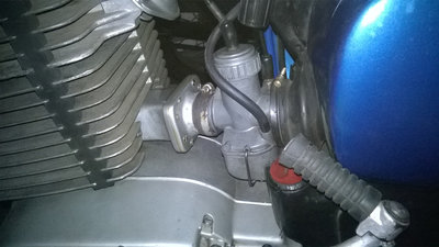

I fitted the lot yesterday evening:
12 - Fitted on the bike.jpg (25.48 KiB) Viewed 306 times
Of course started it, and noticed the apparently complete absence of any reed clatter. This is presumably because these reeds are closed in their neutral position; the reeds on my YZ don't clatter either. I have not ridden it yet - more to follow.

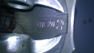

Postby Puffs » Fri May 21, 2021 3:43 am
Well, yesterday I did some 150km with it. The bike ran well; maybe slightly less surging & 4t'ing on the overrun. More importantly: slightly stronger in the low & mid revs, but a bit less potent in the high rev + full throttle (and a bit lower top speed). In all it ran well, but as I remember I previously had more benefit of it. Of course then it did not have the nail, which causes extra drag, and of course that was without that 1mm spacer (and don't worry, I meticulously manage the CR), and with a piston with a shortened skirt:
Megu skirt trimmed.jpg (16.34 KiB) Viewed 306 times
That's the one on the right:
ETZ pistons, trimmed Megu on the R.jpg (12.27 KiB) Viewed 306 times
Not sure if I actually posted these before, now I have. In that setting, the intake opened some 3mm earlier.
