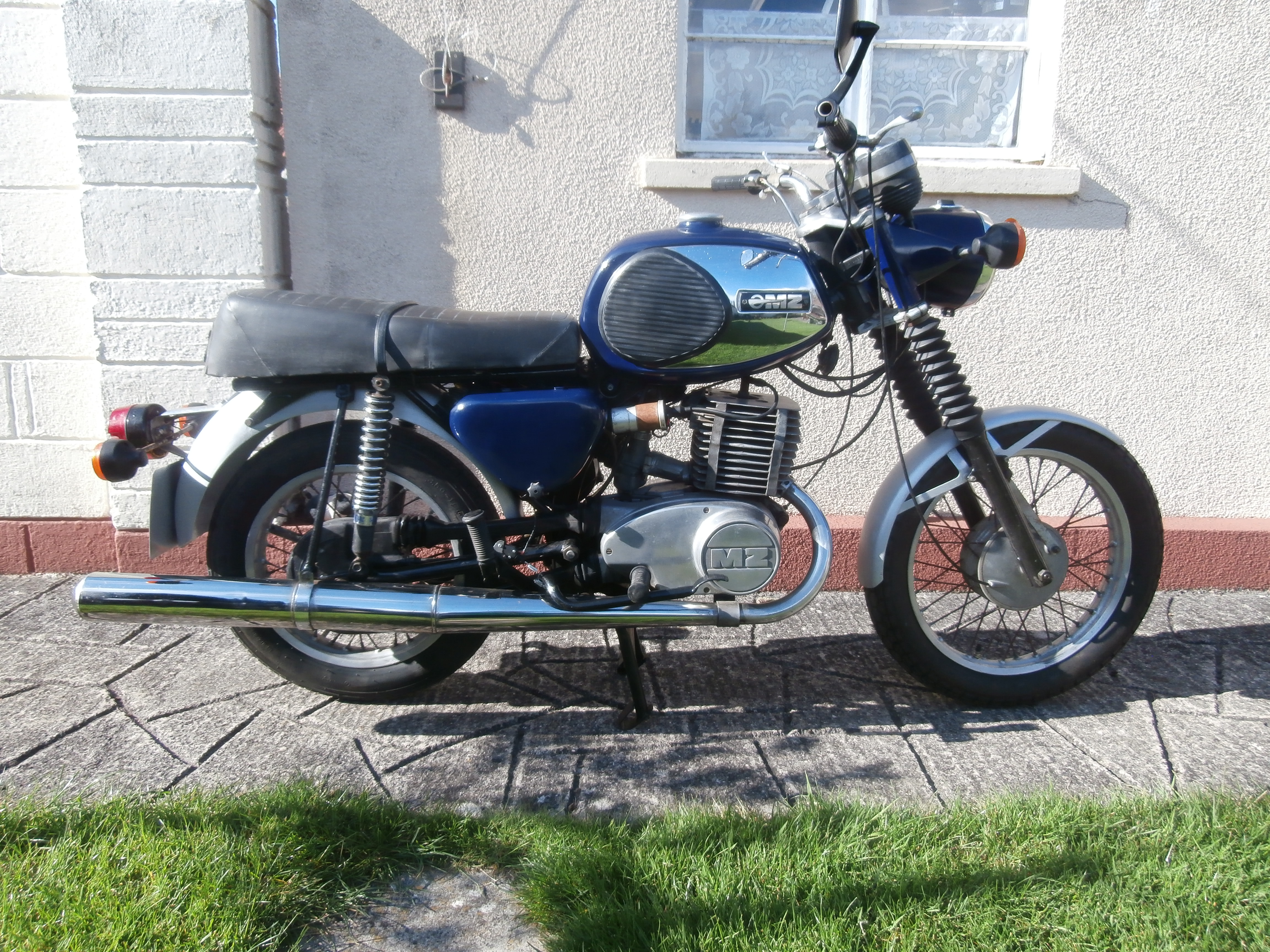

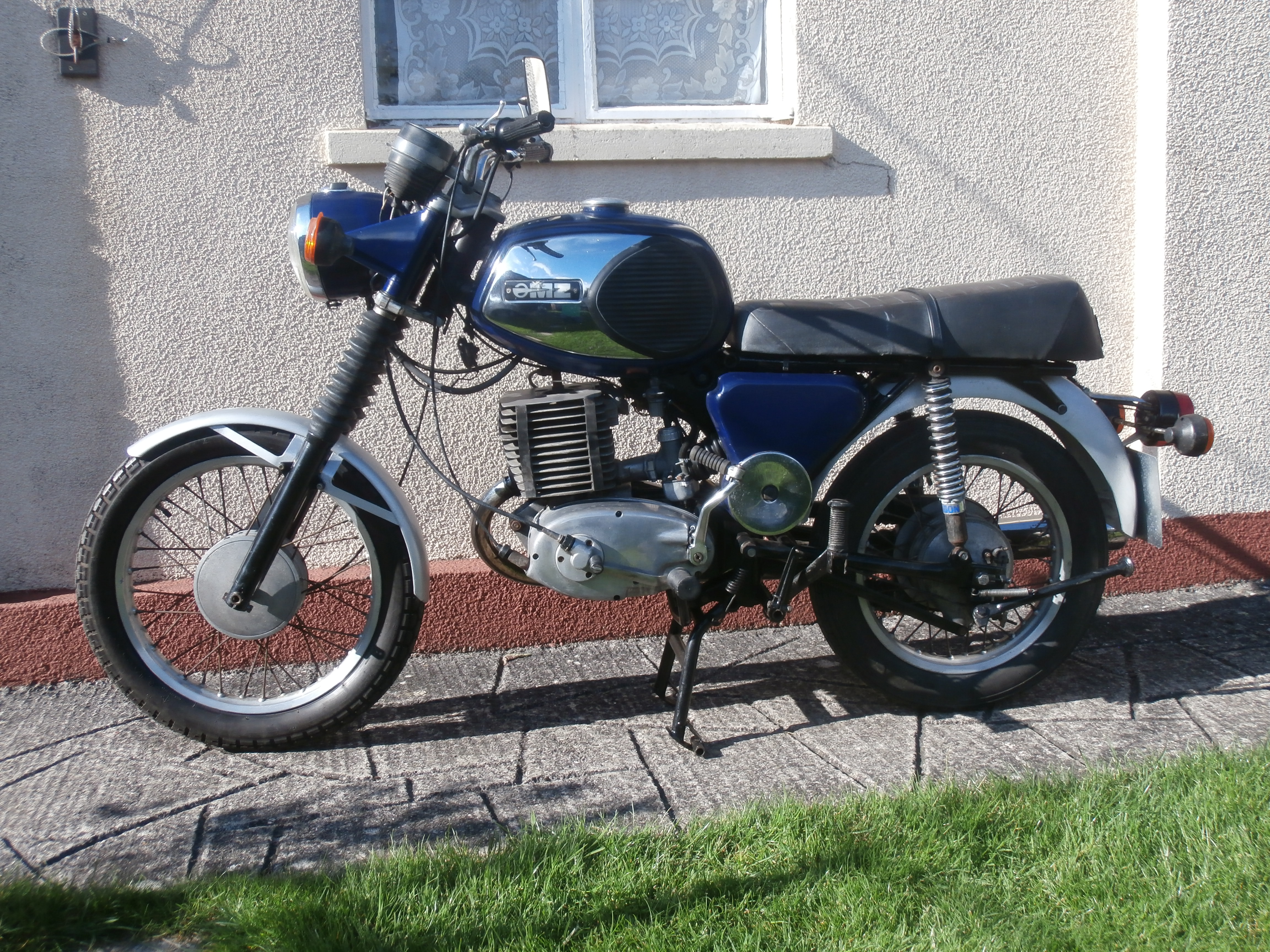

Couple of pictures of the TS.....

Puffs - the handlebars are non-standard, I'll be fitting some "proper" high bars to the bike.
