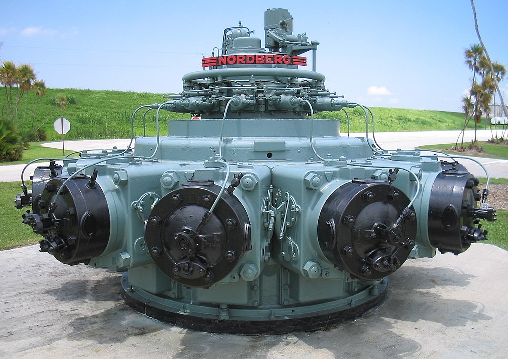

But I have difficulty believing a normal two stroke to run without a spark, like a diesel. From an engineering perspective that makes no sense. Instead, I think something else was going on, like that kill switch making insufficient contact, so that the plugs simply happily continued to spark at their intended timing.
Yes I know there are 2T diesels, but they have a far higher compression ratio, and normally fuel injection.
Or very small, like in model airplanes. Anyway, you need to construct for it.
