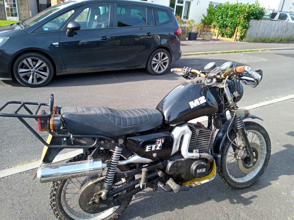

Not mine , saw it for sale on FB marketplace -

maybe he had to cross a small stream getting to his house
have 3 places i go with low water bridges what a pain that can be waiting for the water to go down..

That certainly is an odd exhaust - looks like it has the end section of a standard exhaust grafted onto the end.
Wonder what effect it had on the performance?

Buy it and see... :lol:

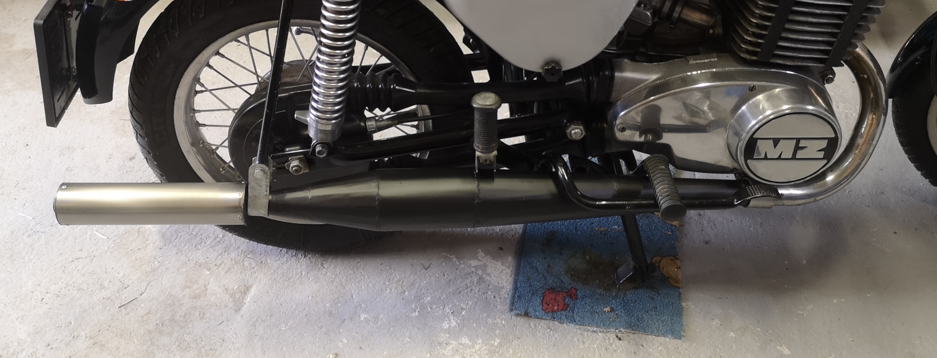

I also tried an expansion chamber, on my TS. I kept the same difuser angle, but made a slightly larger belly diameter. The main difference between this and the original, is the use of a baffle cone, instead of a flat plate.
I kept the tuned lenght of the original (just a tiny bit longer).
Like yours, no major difference in lower revs. However, the high revs is where it shines. It really livens the bike up, in the powerband from 4500 to about 6000 rpm.
Also, an added benefit is the sound. Sounds like a vintage dirtbike.
The first test pipe in picture below.
