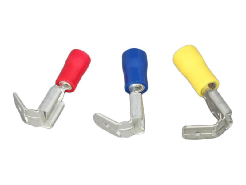

Blurredman wrote:I have put bladed fuse boxes on my other two bikes (ETZ's) so I know the advantages of using them
Don't mean to hijack your thread, but I have toyed with the idea of replacing the O.E. fuse box on my ETZ 125. The only bladed type fuse box I've seen has just single male spade connections ; how did you make the multiple connections ? I am concerned not to add to the number of unreliable connections I already have....
You're right, on the ETZ (and actually on the ES) you need a bridge between two connections before it gets to the fuse. Therefore, on both my ETZ's I have a spade connection with a piggy back on the wire coming from the battery. Then the wire from regulator jumps on the back of that.. Then through the fuse holders.. It's a neater way to do exactly the same as I have done above on my picture (although those wires were just testing wires so didn't need to be neat).

Postby Jay Bee » Sun May 01, 2022 5:33 pm
Thanks, Blurredman - That's exactly what I imagined.
I don't want to sound sniffy about it, but I hate pre-insulated terminals with a passion and I wouldn't use them on any bike (or car).
If I do change the fusebox I'll have to explore other connection methods.

Postby DAVID THOMPSON » Mon May 02, 2022 2:58 am
I remove the plastic part and solder them on
i have a soldering gun that runs on 12 to 19 volts
and they can often be reused if needed for repairing a bad wire
i some times solder the new blade fuses in the circuit and
use liquid tape to paint insulation on open connections
on my 660 Traveller i soldered the coil to the harness after having the spades
become disconnected several times

Postby Jay Bee » Mon May 02, 2022 3:47 am
Thanks, David -
To solder, or to crimp? has long been an issue with motorcycle wiring, and which option you are more comfortable with, a personal matter.
I suspect with your interest in radio that you are an accomplished user of soldered joints.
However, I have always been persuaded to believe that the way to go is crimps ONLY, just as the factory did when they originally made the bike.
I am currently in the throes of re-wiring three British bikes : 2 Triumph 750's and a 6V. Royal Enfield Bullet which I am converting to 12V. All of these have an absolute bare minimum of soldered joints in areas of little movement or vibration. All other joints are crimped.

Postby Puffs » Mon May 02, 2022 3:56 am
Indeed, the issue with soldering is that the solder flows around the wires, also away from the solder point, which makes that part stiff. But bikes vibrate. The section of the cable, just beyond the bit that was stiffened with solder, may then flex under those vibrations, and break.
Nevertheless, I also solder on bikes. Try to prevent cables vibrating.
