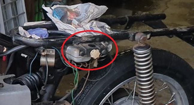

Yes, now that you mention it, the way those rear shocks are mounted seems odd too, without the side covers. I figured there must be a cross beam somewhere, in that rear sub frame, but maybe they're just relying on a heavy-duty rear mudguard between the 2 sides.
To refresh the picture (you linked to yourself earlier):
Which seems to have a shorter gear shift lever.
