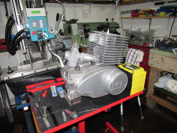

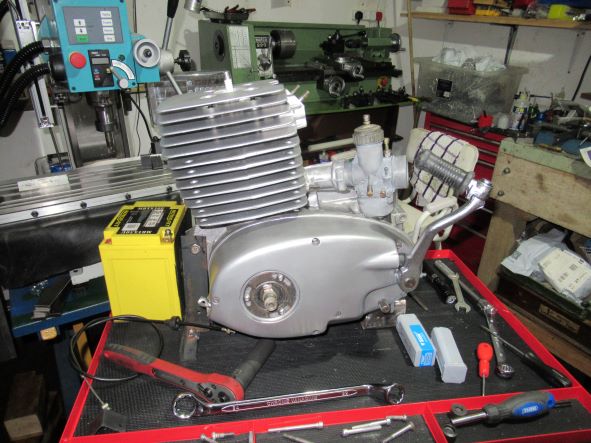

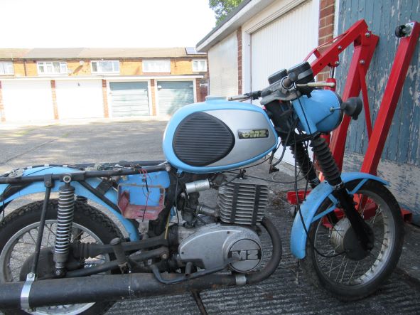

Hope this is not to many pisc.
mick

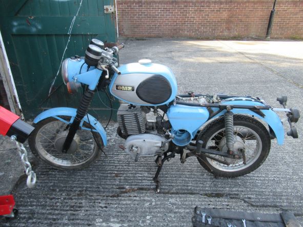

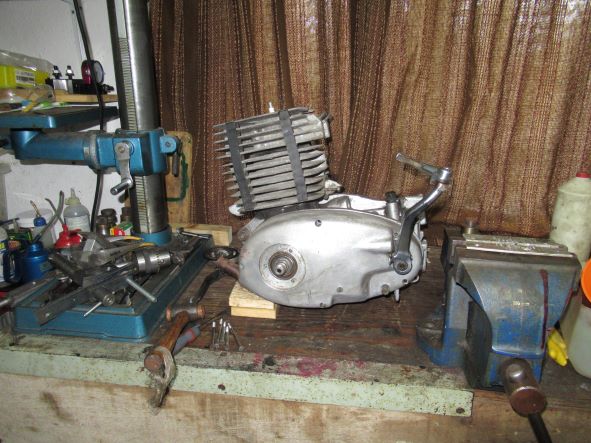

A few more.

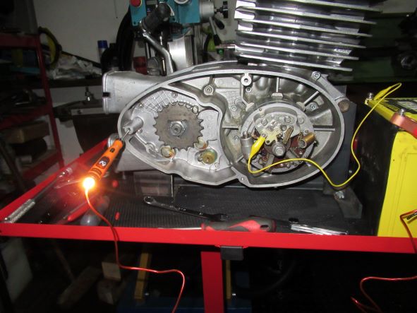

Last ones.
