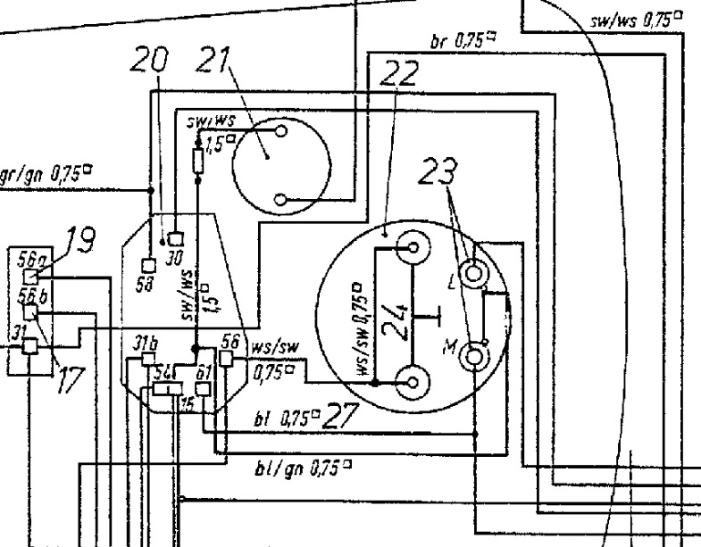

Regarding the idiot lights. It seems I need to connect one (or two) bulbs to item 54 on the main ignition switch. The neutral light only has one connection, the charge light has the connection to the bulb and one on the side that is presumably earth- so.. I guess either the lamp connection or the side connection (I suppose it doesn't matter) just needs a small length of wire to the 54 terminal on the ign. switch. This will replace the small section of loom that does the indicators, that will bridge the connection that is now missing.
Item 23 are the idiot lights. L is the neutral light, M is the charge/indicator light. As you can see with the wiring the switch is 'switched' to ign on, and power will then go to the charge light. The neutral light will light when the ground contact is made in the gearbox, and the charge light will at how it should based on the voltage that it sees coming from the 61 terminal on the voltage regulator. I think it is just like a typical alternator discharge light. The discharge light is normally ON. Then when the engine is running, the regulator senses that it is being charged and the light goes OFF. It will light dimmly or fully when there is excessive draw. So yes I should just need to bridge the connection from ign. switch to the charge lamp.
EDIT: I'm getting a little confused actually regarding this. Because the attached image shows it connecting to 54? But in the official manual it states 15. I suppose they both will operate ignition live so It could be either one I suppose (?) Oh well- I'll experiment and see.
EDIT: Yes Dave, that is true I think you're corredt. I think terminals 54 and 15 are conjoined. There is no way that all the items the ignition on condition would connect too all that it does without them being one unit. The original manual has the two bubbles 15/54 touching like they are conjoined. What's more, on the TS125 6v diagramme, it shows a different wiring whereby the indicators are coming off terminal 54 as opposed to 15 and other such things. This is why 15/54 is only represented as a single square in the 'switch54' picture. As you can see, there is a live connection from terminal 61 to the charge light and thus the voltage regulator. I've heard these 'emergency positions' don't even work.. There are some hills on the way home.. Maybe i'll experiment with what that does. But- I have a full battery so might be pointless.
As attached.

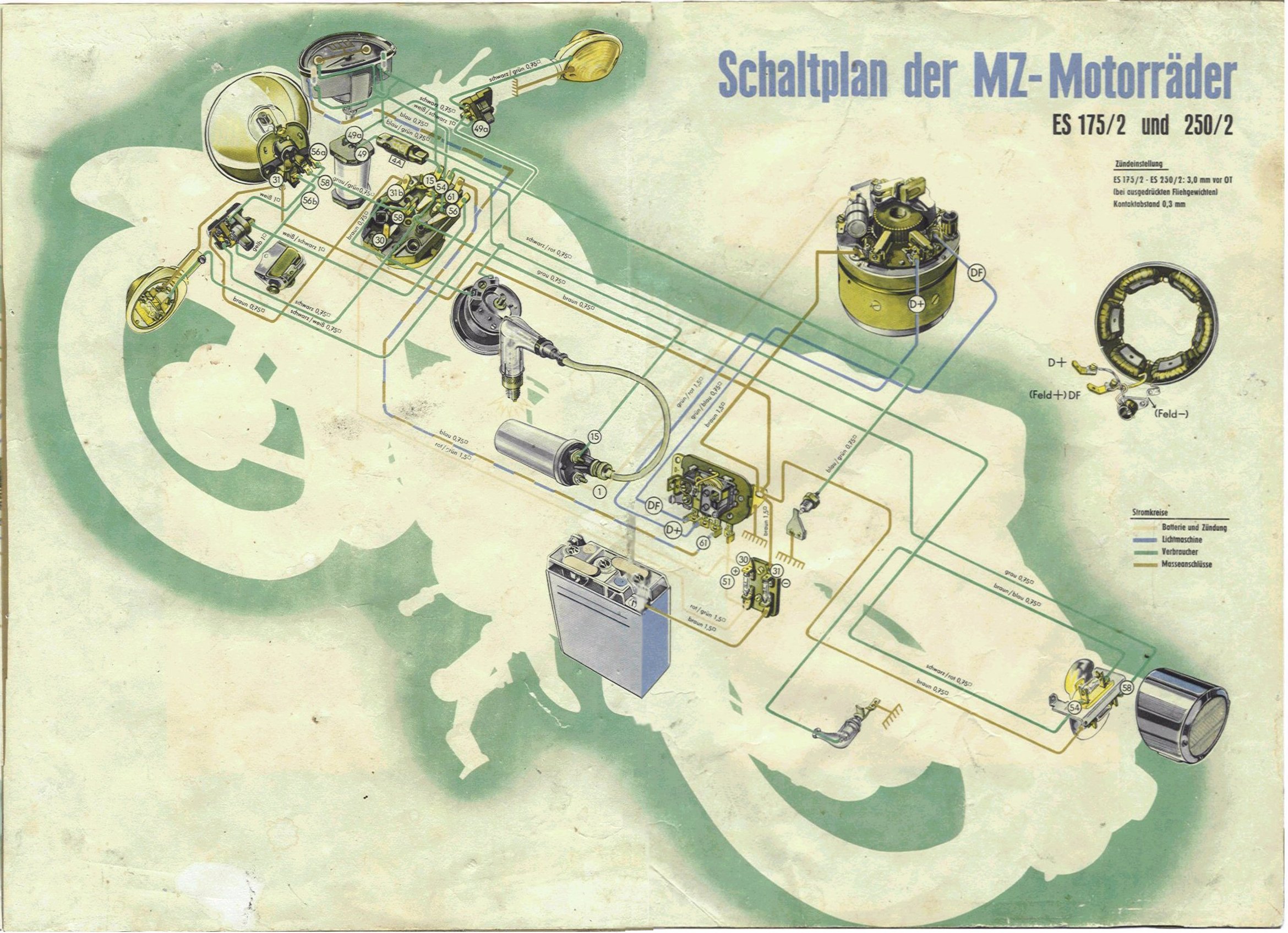

I don't envy you working from the horrible MZ wiring diagrams. The ETZ circuit diagrams were much better.
Both control lights are probably fed 6v by a single wire from terminal 15/54 on the ignition switch. As you say, the other wire from the neutral light goes to the neutral switch and then to earth when in neutral, and the other wire from the charging light goes to terminal 61 on the voltage regulator.
Two complications are:
1. There may be another wire from the charging light to terminal 61 on the igition switch. This is part of the emergency, flat battery feature, which is not really necessary in my opinion.
2. The charging light doubles as an indicator warning light, also unnecessary if you have no indicators.

So yes I did manage to do some things last night. I put a bridge wire between 15/54 and the vacant spade terminal on the charge lamp (that the indicator loom would wire to) and now both lights act independantly. Charge light disapears when the engine is started (but equally comes on dimmly when at a low idle- so that's good), and the neutral light acts as it should. Good! Thanks Dave.
