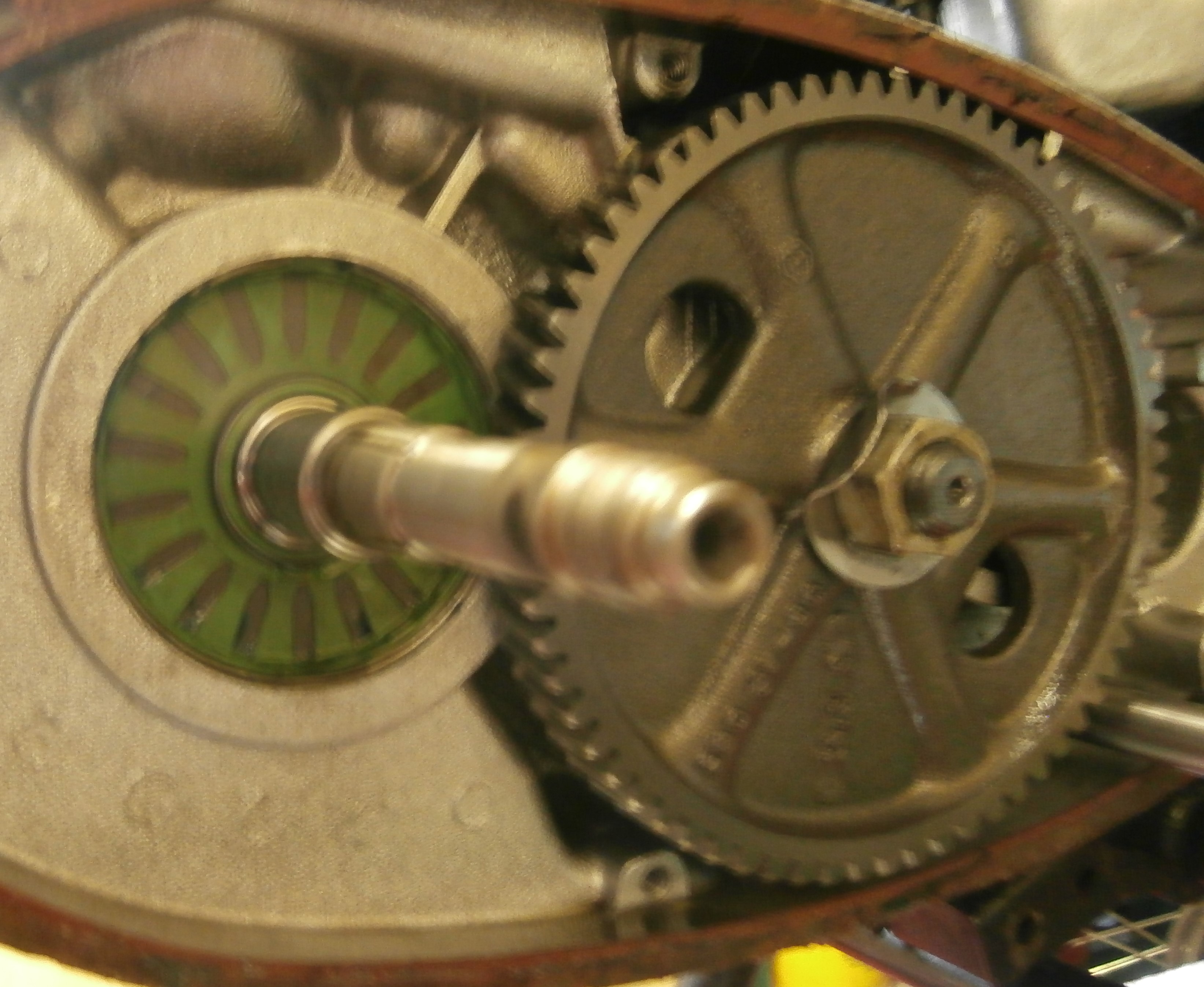

Postby Andy_C » Sat Jul 10, 2021 2:27 am
OK so with a bit of gentle tapping off came the case, then out with the clutch extractor to get the clutch off.
The crank seal looks pretty new - see the picture below, no signs of rust on the crank that I can see.
The one on thetiming side is the same colour seal and also looks new, but it is fitted the other way around to the one in the picture below.
My question now is which way round should they be fitted?
Andy_C
Posts: 338
Location: Somerset
Re: TS250 5 SPEED
Postby dave47 » Sat Jul 10, 2021 3:32 am
Both your seals are fitted the right way, ie flat side facing right.
dave47

Postby Andy_C » Sat Jul 10, 2021 12:36 pm
Another update.
I pulled the drive seal out this afternoon, the rear of the seal facing the crankshaft was pretty discoloured, suggesting that there has been / is blow past the piston.
I have not checked bore / piston clearance so no idea about the bore / piston clearance. The engine is very quiet, and has plenty of compression if that is anything to go by.
By the looks of it the seal has been in there for sometime.
Looking at the seal there is no discernable lip on it, where it contacts the crank it is just flat.
No signs of rust / pitting on the crank - it looks perfect.
So I am optimistic that the seal is at fault, I'll know when I fit the new ones next week - not pulled the one on the timing side yet.
Andy_C
Posts: 338
Location: Somerset
Re: TS250 5 SPEED
Postby Blurredman » Sat Jul 10, 2021 1:03 pm
If I were you I would fit this new seal and see how it goes.
You've mentioned in YT videos about the possibility of seepage past the crankcase. This has come up before, and someone has found on this forum that they were missing the black rubber disc that can be forgotten that sits in a recess on the left hand crankcase at the top near the conrod clearance.
Though, like I say- i would just do this green seal first :)
