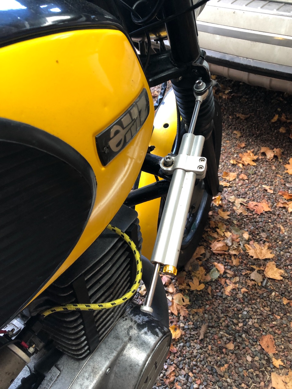

Postby ScotBob » Sat Jan 28, 2023 12:26 pm
I had this on my TS250 combo:

Postby lavrentyuk » Sat Jan 28, 2023 4:34 pm
Seems to be the way I'm leaning.
