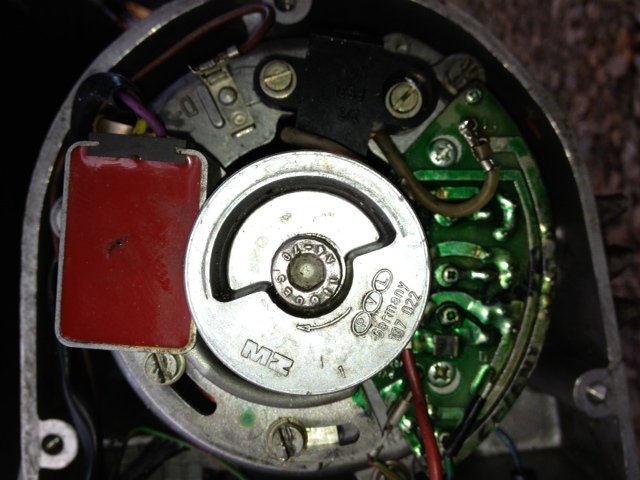

I've started my next MZ project - another 301 - but the wiring loom has no voltage regulator or rectifier. I'm sure I've read somewhere some PVL ignition systems have the regulator and rectifier built in?
Here's a photo of the ignition as fitted to the bike.
Any ideas please?

Yes according to what I can see the block contains a regulator rectifier. Be very careful what you do because the PVL unit is very easy to kill!

The regulator/rectifier unit is the green printed circuit board screwed to the alternator.
The PVL ignition unit is fed power through main wiring loom, (battery > ignition lock > kill switch > coil and PVL unit (purple wires)). Someone suggested wiring a capacitor "across the PVL", wasn't clear to me how, anyone able to advise?
