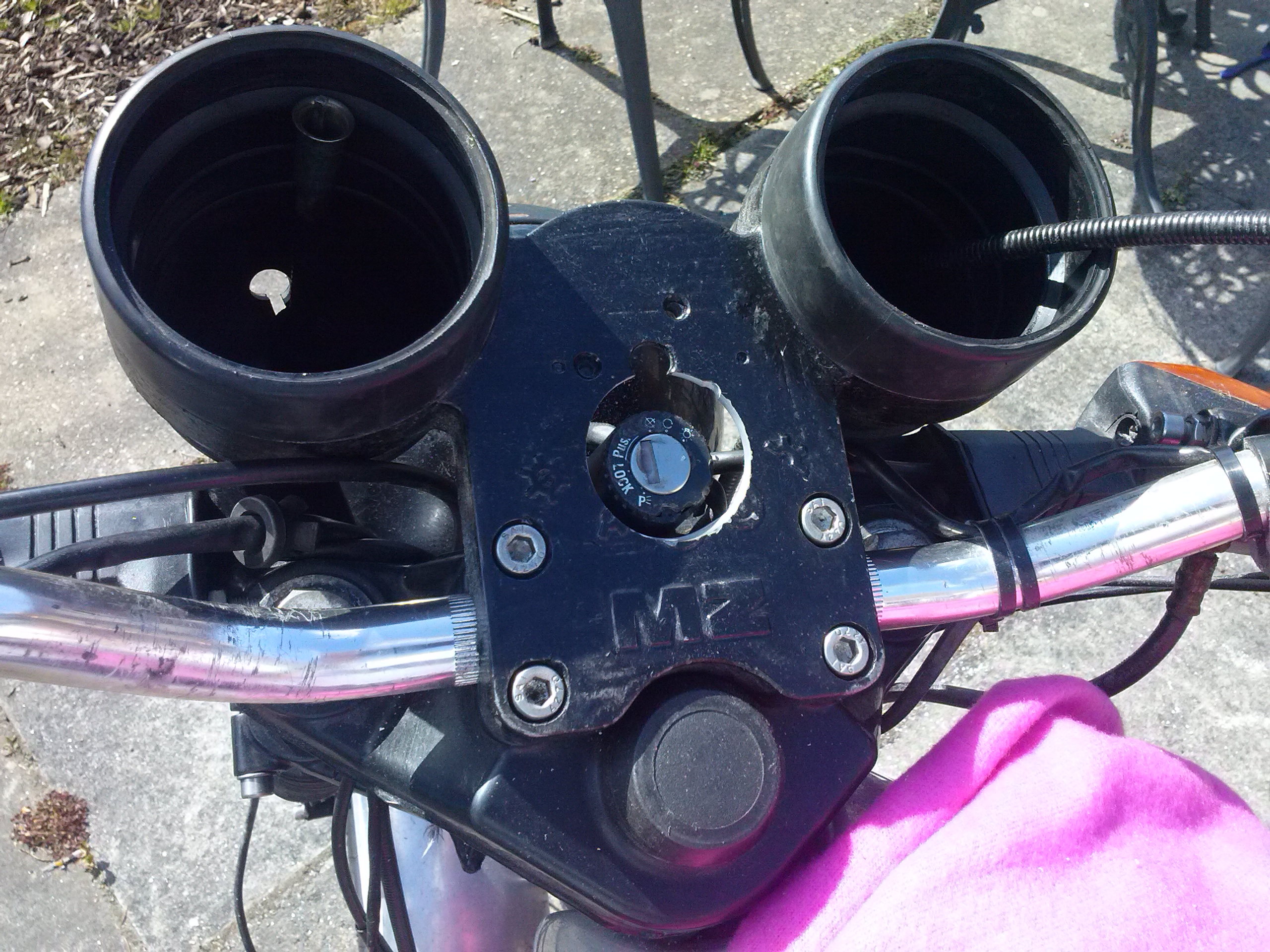

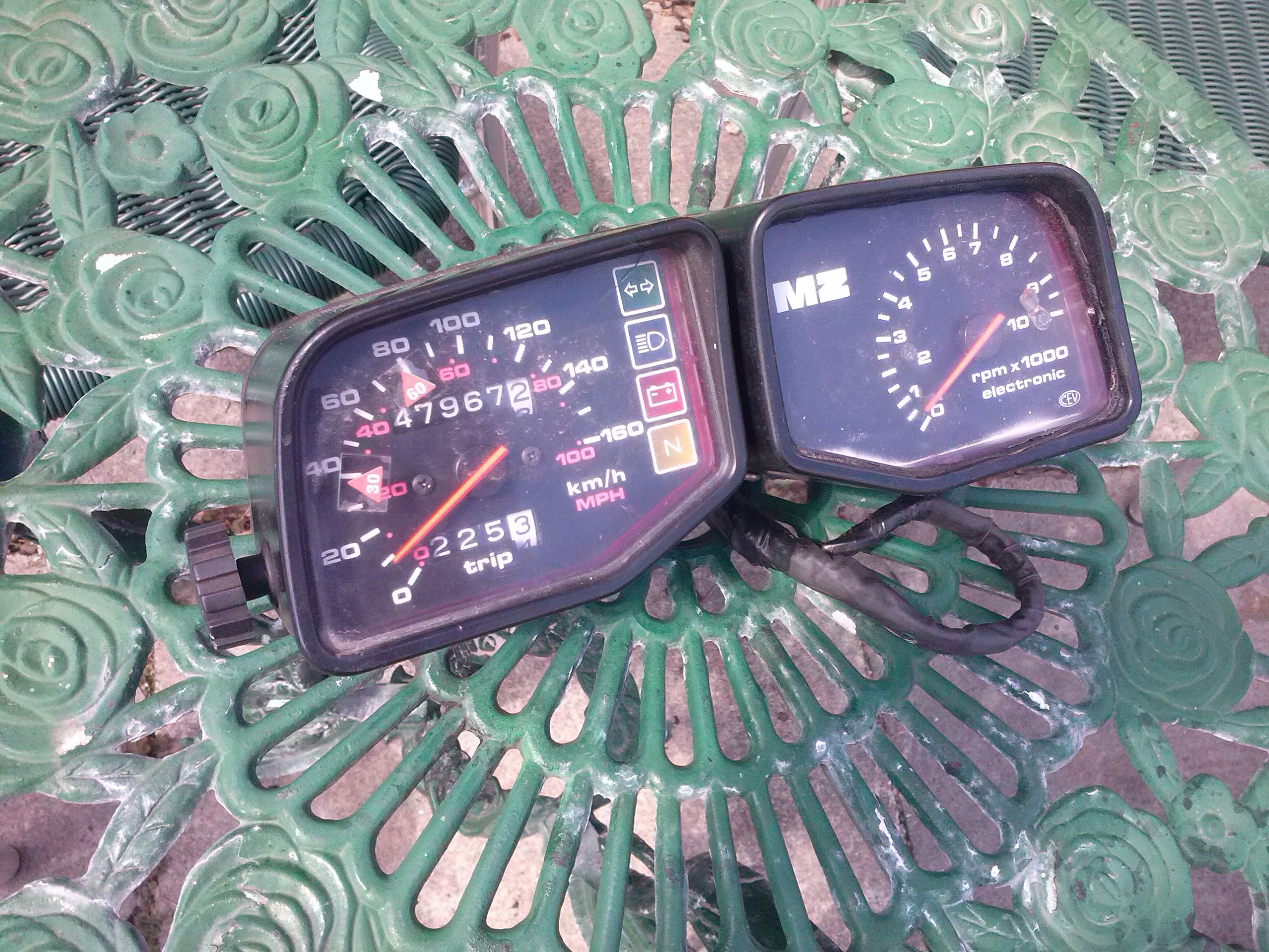

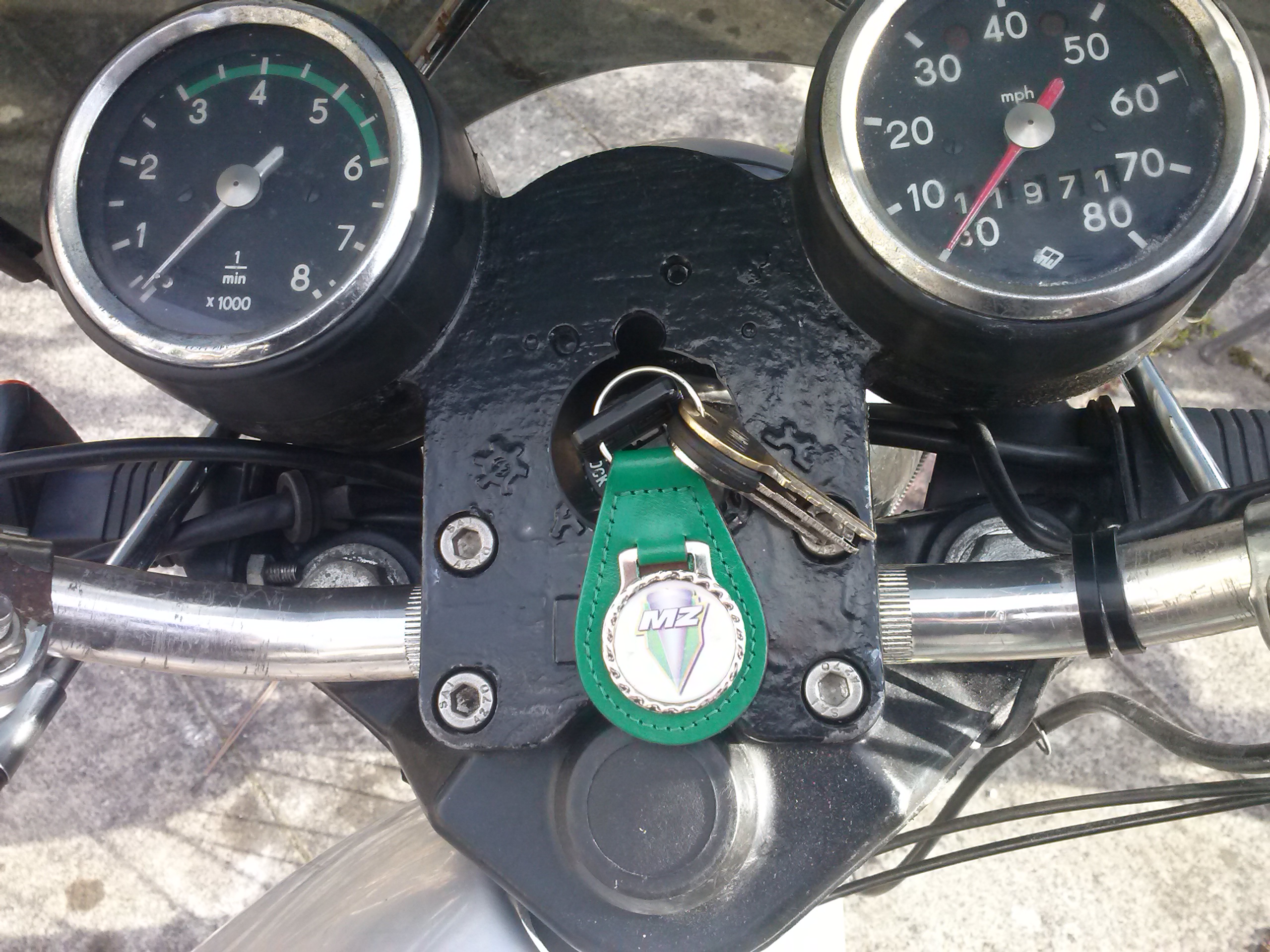

I bought some TS I think gauges for my Kanuni ETZ it already had earlier gauges fitted but because of my charging system the electronic rev-counter couldn't be used. but I wanted to keep the later ignition switch and steering lock a big hole was drilled I will sort out the cosmetics when the weathers to nasty for riding,,,,,,,,,,,,,,,,,,

Postby vicar » Tue Jun 24, 2014 10:35 am

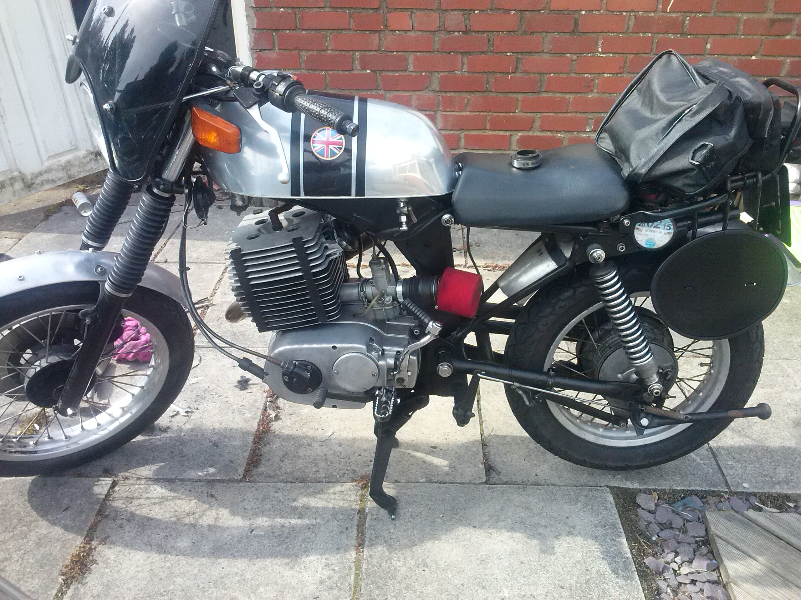

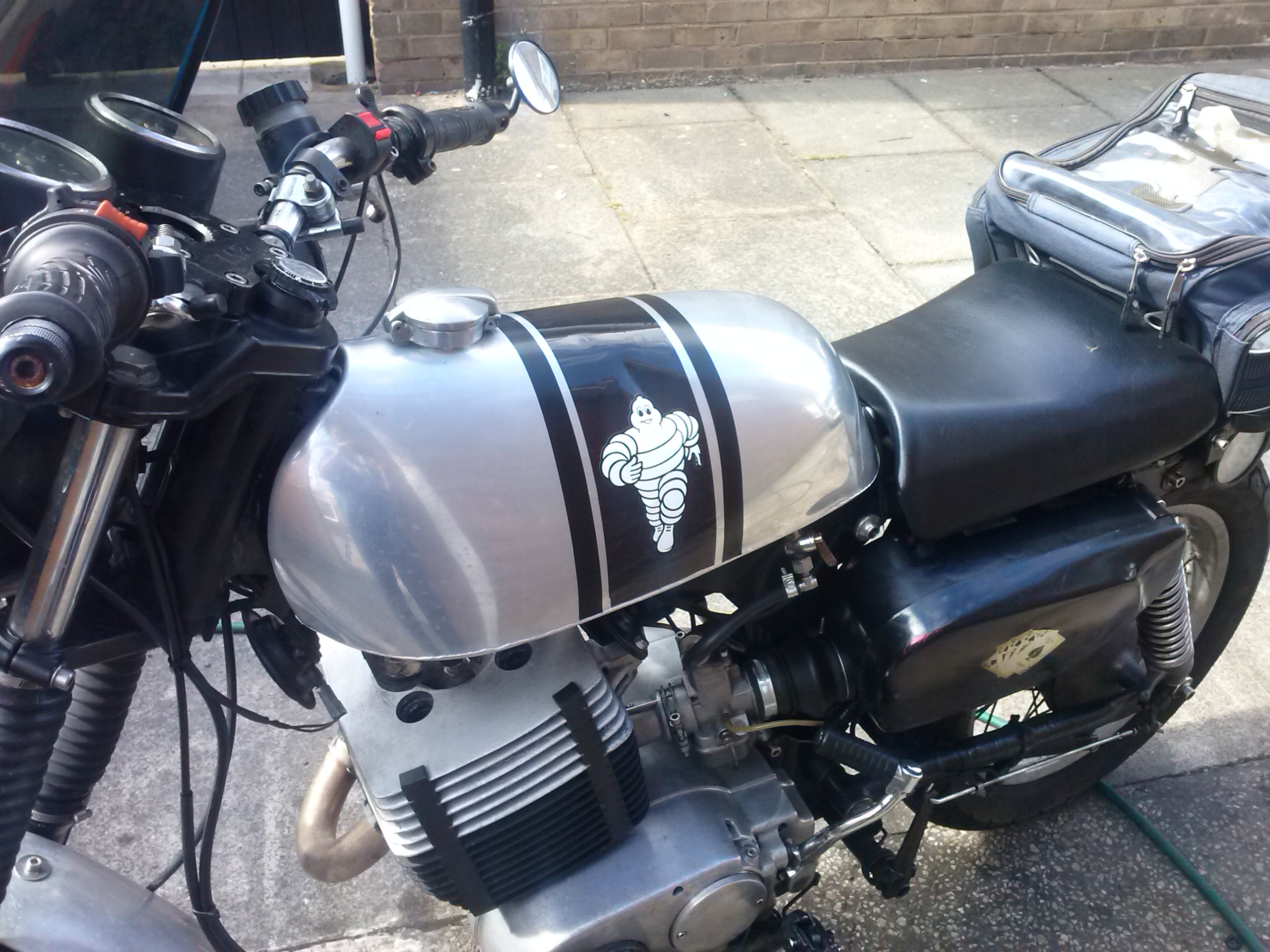

Oh forgot to mention the value of my bike has rocketed it is now a low mileage bike after the clock swap.........And what do you think of the AC Cobra stripes on the tank 2 strips of insulation tape an a bit of window tinting film, again an expensive mod .....................Road tires fitted cos the enduros didnt like corners. I now have a golden boy Korean on the back and a Cheng Shin on the front Both part worn £17 the pair inc postage from flea bay This was extortionate but if you want the best it costs. I am achieving my plan of a multi national bike...

Very nice! Hope the Michelin Tire Guy is not too put out by your street tire selection!

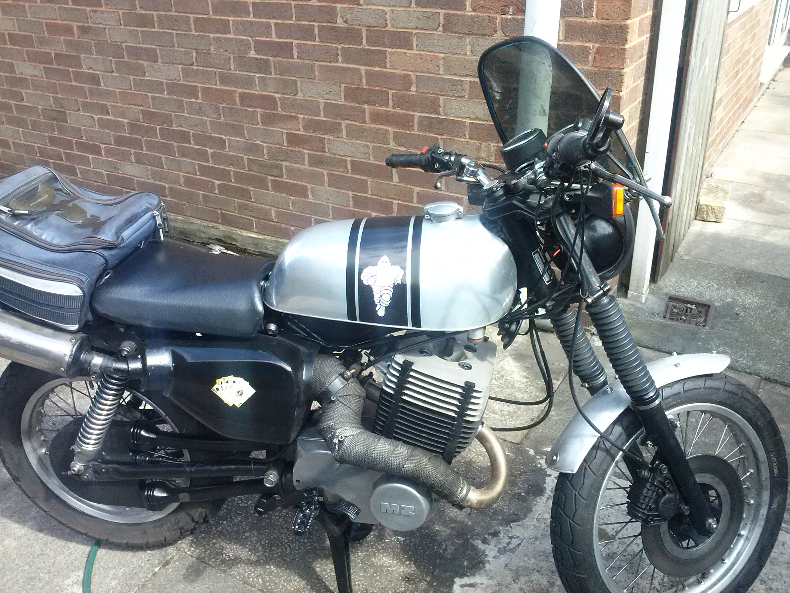

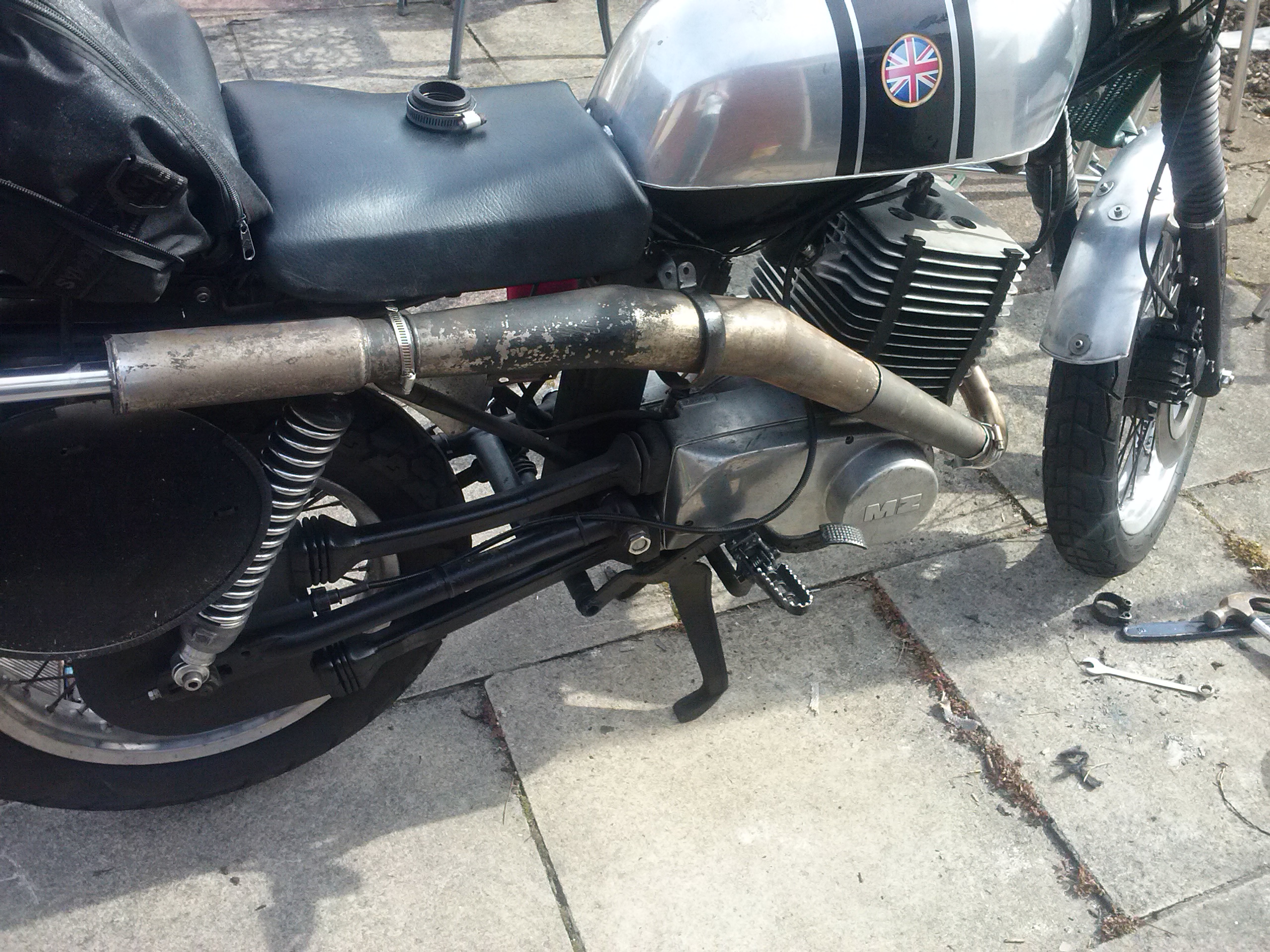

The exhaust on my bike was home made it had plenty of volume but no tapers and a lot of bends.and it wouldn't rev out
After digging about a bit I found an other exhaust in the pile of junk I call my shed.volume wise it is similar to a std exhaust but the baffling silencer bit at the end of the exhaust is a lot less restrictive .
I have taken it for a test ride and its ok, the bike buzzes up to 70mph in fourth no problem. its a work in progress got to decide if its side panels or not ,and I will keep you updated and like all my mix n match its all free bits......

Postby DAVID THOMPSON » Thu Aug 07, 2014 12:25 pm
watch the heat that exhaust may get you a holy piston
piston tops take a beating if things are not correct
