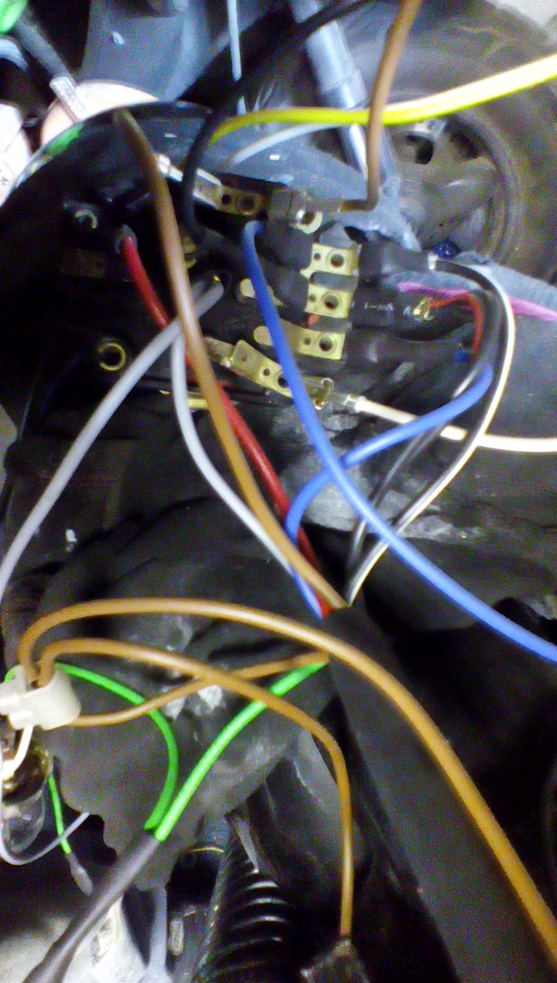

hi all at wits end trying to sort out wiring (new loom) on the ignition switch on my trophy es250 the numbers on the back don't seem to correspond with the colours a few pics or simple diagram would be gratefully appreciated many thanks Mick

Postby mickster » Mon Aug 31, 2015 2:50 pm
will give it a go when I get home from work .many thanks if it don't work will post some pics of ignition

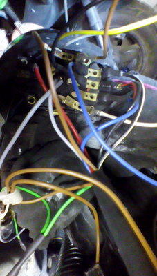

run out of fuses can anyone see any obvious mistakes with wiring positions on ignition switch looking the will to live ha ha keeps blowing fuses thanks Mick

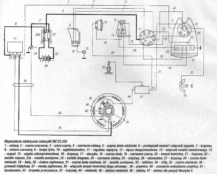

Postby den » Wed Sep 02, 2015 2:57 pm
could try this,
MZ ES250 wiring photo
or read through this,,
Another MZ Trophy Project.pdf
