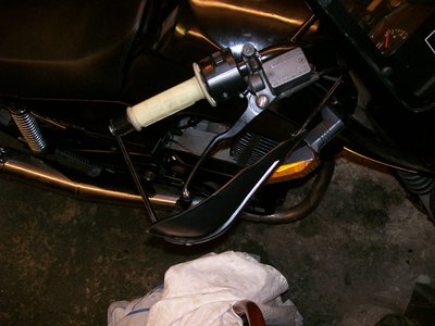

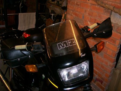

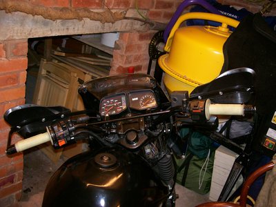

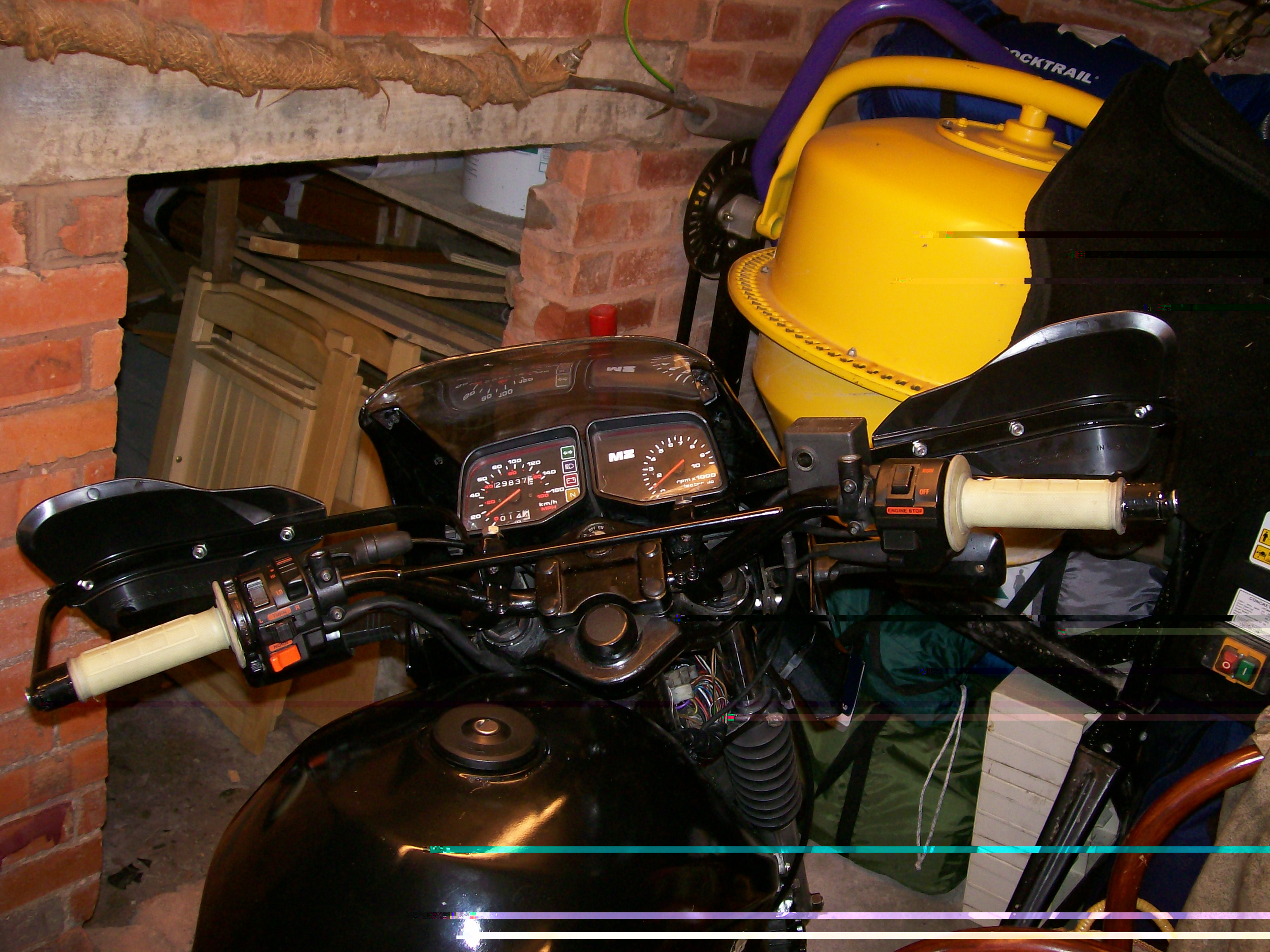

Postby paulatradese-6 » Sun Sep 14, 2014 8:14 am
Got fed up with cold hands and no handguards would fit. So Made my own.
Clamps and plastic are from cycra, probend.
Bent some Wickes 14mmx5mmx1m flat bar into a nice curve using an old fork stantion.
