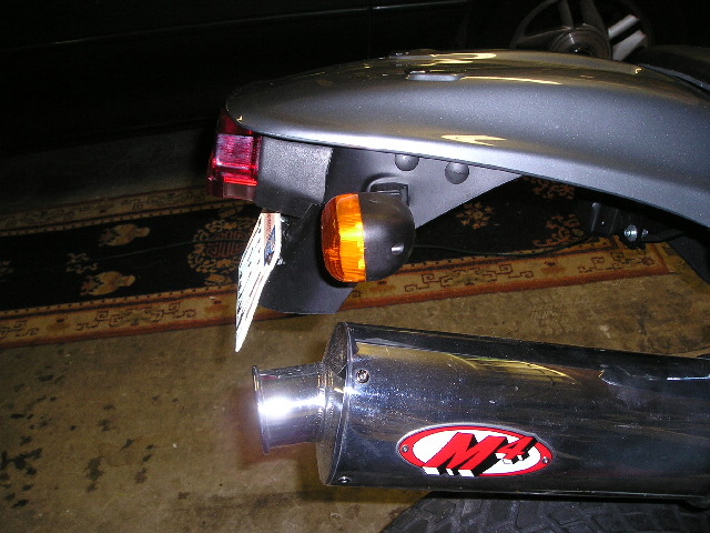

Postby Brian » Wed Feb 25, 2004 4:52 pm
You can see the rear brake light is flush with fender.....

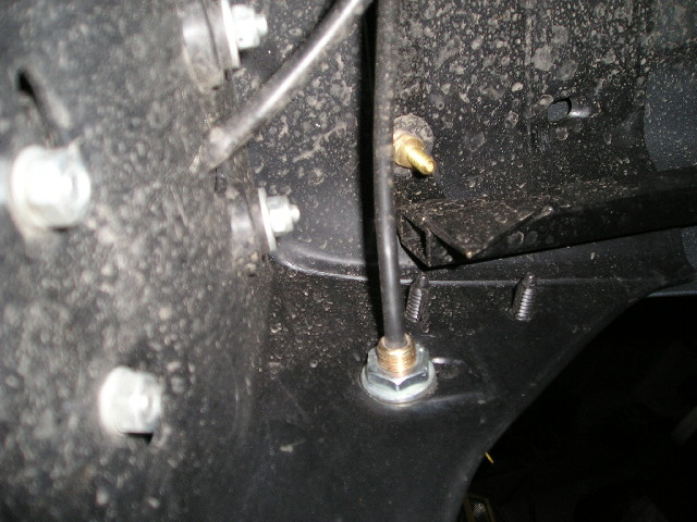

Postby Brian » Wed Feb 25, 2004 4:54 pm
You can see the cut of the fender in relation with the rear light, you can see the black plastic push ins to cover the reflector bolt holes. My pipe now is right up against my turn signal

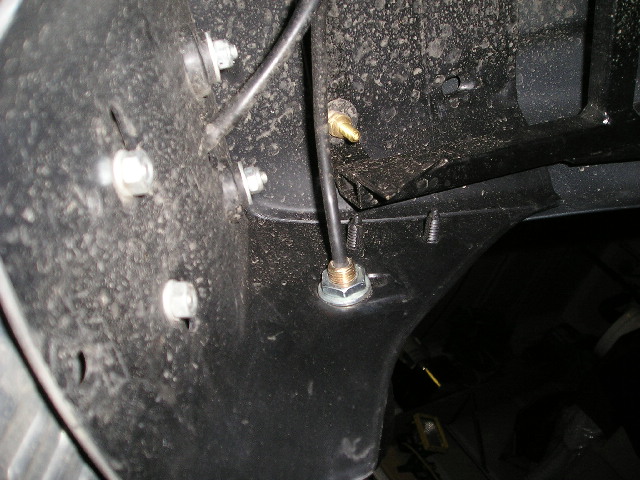

Postby Brian » Wed Feb 25, 2004 5:05 pm
to the far left of the picture what you don't see is the 5/16" carriage bolts holding the cover to the frame..... underside picts next

Postby Brian » Wed Feb 25, 2004 5:32 pm
What your looking at is the lefthand side under fender... the tee bolts/nuts are all brass, to the right are the original holes, you can see the plastic pushins as well where I cut the frame

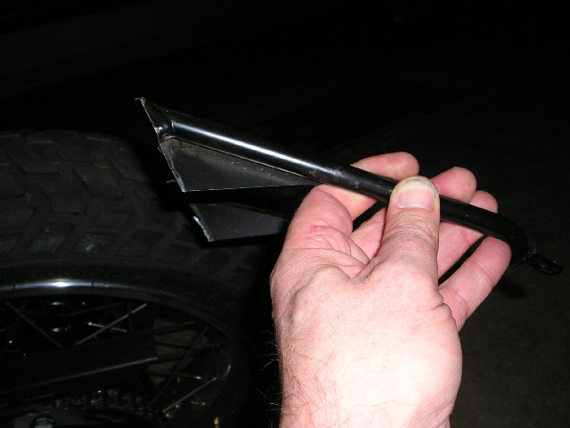

Postby Brian » Wed Feb 25, 2004 5:36 pm
#3

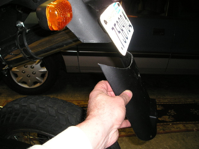

Postby Brian » Wed Feb 25, 2004 5:37 pm
By this picture you can see at which intersection I made the cut....

Postby Brian » Wed Feb 25, 2004 5:39 pm
The camera has a weird way of showin up stuff you do not normally notice like the skid lines of this cut.....To make the cut I took the lower fender which almost dragged on the street and used it for a template... I have since cut off excess threads etc and touched up with black to make it look factory.... I'm no craftsman but I think the job looks factory done.... the bike looks really good...
