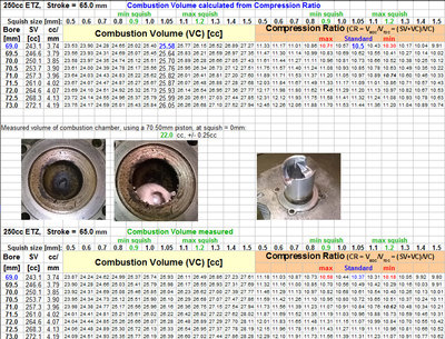

While I believe it's too little squish clearance that can encourage detonation (higher average pressure & more difficult for the mixture to escape from the squish band --> in that band, locally even higher P & T), I'm not too worried about this size of the squish, for my 71mm bore. Nevertheless, I crunched some tentative numbers:
250cc ETZ, bore, squish, compression.jpg (18.31 KiB) Viewed 18304 times
Which suggest that compression ratio-wise I'm pretty much on spec.

The next episode focussed on actually measuring the size of the combustion chamber (using a syringe & water). The earlier table above inferred that size from the specified compression ratio of 10.5 (but slightly wrong), which gives small differences compared to the volume measured on my head:
Squish & CR.jpg (68.9 KiB) Viewed 18304 times
Now of course the actual pressures very much depend on the degree of filling, particularly on a 2T, but when using RON95 fuel, at these CR's the chance on detonation is pretty dim.

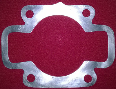

As I also wanted to perceive the impact of a Maß A = 14mm barrel, I made a 1mm thick spacer:
Cylinder base spacer, th = 1.0mm.jpg (42.64 KiB) Viewed 18304 times
In view of anticipated squish heights, the barrel was assembled with just silicone sealant, in addition to this spacer. So no gaskets, also not below the head; for now also there the silicone seems to provide a sufficient seal on an accurately torqued head. The squish height was measured at 1.18mm.
The bike runs fine, compared to the original Maß A = 13mm, more torque low down, and it doesn't bog down so much on low rev + full throttle. But the top end has reduced a bit, and it doesn't go as willingly into the highs, and actually also top speed has come down a bit. Nevertheless, for the bike that it is, I like it better like this.
