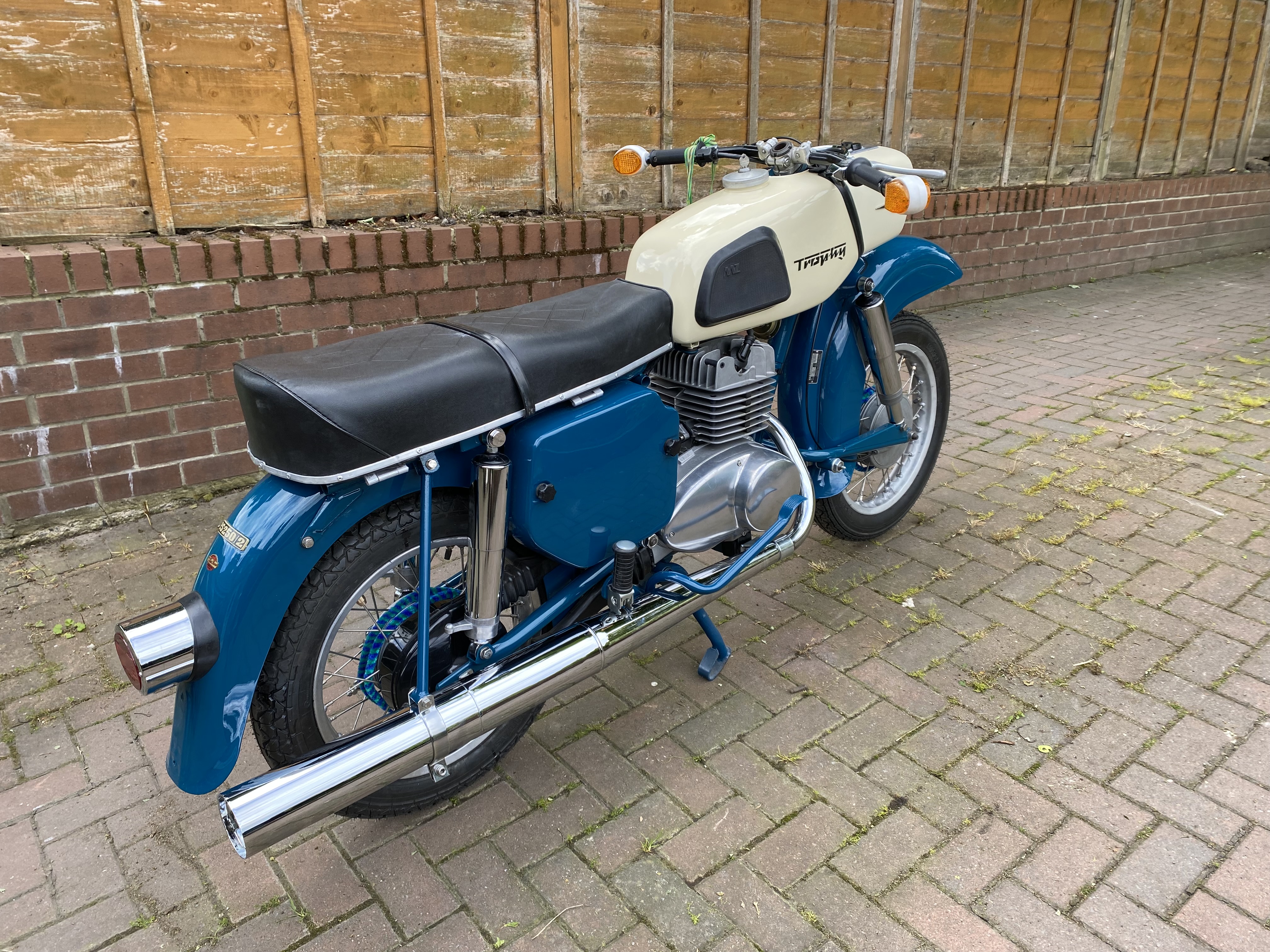

Lovely looking bike that, obviously a very thorough restoration, how do you like it?
I`m no expert but for what it`s worth I thought the engines in the ES and ETS were the same.

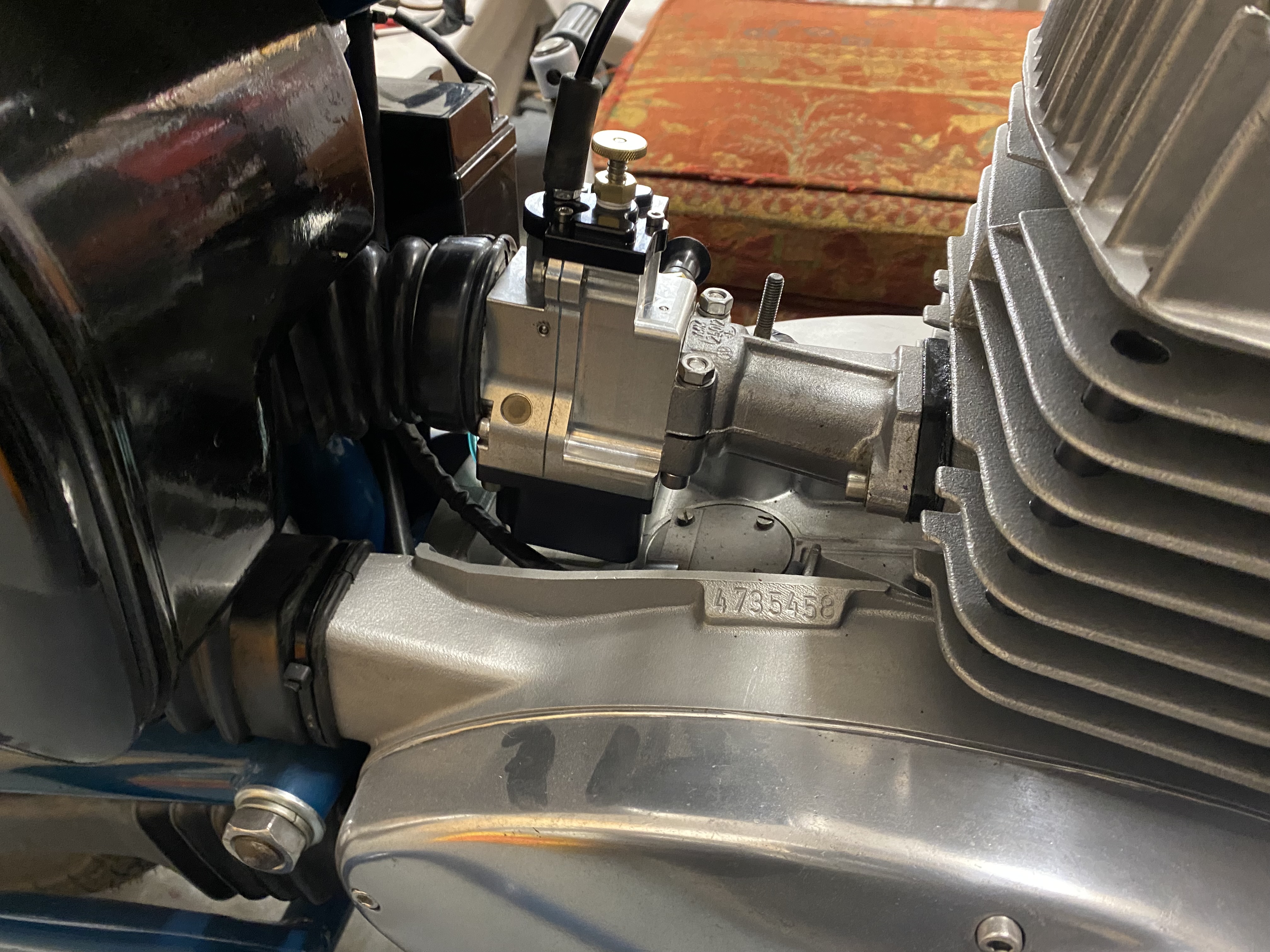

The ES, I've done a comprehensive build, altered 4th gear ratio, blueprinted the engine as closely as possible, balanced the crank to 55%, cerekoted the piston and fitted the Smart Carb (The carb without jets) unfortunately I haven't ridden it due to health issues but I hope to soon.

Postby Blurredman » Mon Jul 22, 2024 1:55 am
Nice bike! I would like to know how that smart carb operates!

The Smart Carb, they have cleverly vented the float chamber into the venturi which raises or lowers the fuel level in the float chamber to meet demand. Its more complex than that but that's the principle and it delivers fuel throw one nozzle that you or I would call a main jet. Changes in atmospheric pressure are compensated by adjusting the needle height by a knurled nut at the carb top which takes seconds, likewise you can richen or weaken the same if you fitted an expansion chamber for example.
That's the principle but it is a little more complex but not in operation just build etc.

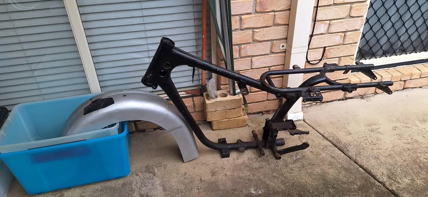

Well, some time has passed since the last update was posted about this project. DirtSurfer had other time constraints that needed his attention, so a few weeks ago this motorcycle has come into my possession and is now relocated 1,000 km's north to Brisbane (Australia). Everything arrived well packed with all loose parts bagged and clearly marked. It appears to have not run for several years but thanks to the preparation work DS had done, it didn't take too long to get it started and running. Put fresh oil in the gearbox, started the engine and cycled thru the gears with the bike stationary and everything seems to be working just fine. Dropped the oil out even though I only ran it for a couple of minutes and oil is clean, so a good sign. Bike is now completely stripped and heading to the powder coaters and vapour blasters next week. New Mikuni VM28 has arrived and am awaiting a bunch of gear from Germany to arrive. All being well should be back on the road by late August.
If anyone knows the colour code for the red paint would be appreciated.
Interesting find in Wikipedia = Of the 16,222 ETS 250s produced, the majority (12,723) were sold in the GDR with just 64 being exported to Australia.
